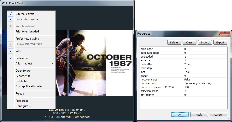

Get Covers (Artwork)
version "06052016"
// @name "Get Covers (Artwork)"
// @author "kgena_ua"
// @version "06052016"
// @feature "v1.4"
// @feature "watch-metadb"
function RGBA(r, g, b, a) {   return ((a << 24) | (r << 16) | (g << 8) | (b)); }

            if (typeof covers[covernumber] != 'object'){
                cover_name = covers[covernumber].substring(covers[covernumber].lastIndexOf("\\") + 1);
                cover_width = gdi.Image(covers[covernumber]).width;
                cover_height = gdi.Image(covers[covernumber]).Height;
                cover_size = fso.GetFile( covers[covernumber]).size;
                if (cover_size > 1024 * 1024){
                    cover_size =  Math.round(cover_size / 1024 / 1024 * 100) / 100 + " MB"
                } else if (cover_size > 1024){
                    cover_size = Math.round(cover_size / 1024 * 100 ) / 100 + " KB"
                    cover_size = cover_size + " Bytes";
                cover_size = "   " + cover_size;
            if (typeof covers[covernumber] == 'object'){
                cover_name = "embedded";
                cover_width = covers[covernumber].width;
                cover_height = covers[covernumber].Height;
                cover_size = "";
            gr.GdiDrawText(cover_name, font, b_color, 0, text_y, ww, wh, DT_CENTER | DT_WORD_ELLIPSIS );
            gr.GdiDrawText(cover_width + " x " + cover_height + "" + cover_size, font, b_color, 0, text_y + text_h, ww, wh, DT_CENTER | DT_WORD_ELLIPSIS );
            info_text = covernumber + 1 + " (" + covers.length + ")   " + external.length + " external   " + embedded.length + " embedded";
            gr.GdiDrawText(info_text, font, b_color, 0, text_y + text_h * 2, ww, wh, DT_CENTER | DT_WORD_ELLIPSIS );
    if (!g_img) {
        gr.GdiDrawText("no image", font, a_color, 0, 0, ww, wh, DT_SINGLELINE | DT_CENTER | DT_VCENTER | DT_WORD_ELLIPSIS );
    if (typeof covers[covernumber] != 'object' ) {
        if (covers[covernumber]) WshShell.run( '"' + covers[covernumber] + '"' );
    if (!delay && !ShiftDown && covers.length > 1){
        delay = true;
        fdelay();
        next_image(delta);
    if (ShiftDown) {
    window.SetCursor(32649);
    window.SetCursor(32512);
function fdelay(){
        delay = false;
    }, 200);
function on_key_down(vkey) {
    if (vkey == 16){
        set_cycle = true;
        dis_set();
function set_cycle_timer(){
        step =  set_cycle || file_operation ? 0 : step + 1;
            if ( covers.length > 1) next_image(1);
            step = 0;
    }, 1000 );
function dis_set(){
    dis = 0;
        if (set_cycle) {
            dis++;
            if(dis == 1) {
                set_cycle = false;
    }, 1000 );
var ftimer;
function fader_timer(){
    fader = fader + fade_step;
        if (fader >= 255) {
            fader= 255;
            window.ClearInterval(ftimer);
    }, 10 );
function change_filename(){
    var c_file_name = get_file_name(covers[covernumber]);
    var nl = "\" + chr(10) + \"";
    var input_box_text = nl + "Enter new file name";
    var n_file_name = input_box(input_box_text, c_file_name, "Foobar 2000");
    if (n_file_name) {
        try {
            var dir = covers[covernumber].replace(/\\([^\\]*)$/g, '');
            var ext = covers[covernumber].replace(/(.*)\.([^\.]*)$/,'$2');
            fso.MoveFile( covers[covernumber], dir + "\\" + n_file_name + "." + ext );
            get_covers();
            for (var i = 0; i < covers.length; i++) {
                var name = covers[i];
                if (get_file_name(name) == n_file_name) {
                    covernumber = i;
        } catch(e) {}
    file_operation = false;
function delete_file(){
    var source = covers[covernumber];
    var button_type = is_read_write(source) ? 0x3 : 0x5;
    var icon_type = is_read_write(source) ? 0x20 : 0x10;
    var second_button_is_default = 0x100;
    var btn = WshShell.Popup("Delete file:\n\n" + source, 0, "Foobar 2000", button_type + icon_type + second_button_is_default);
    switch (btn) {
    case 6:
        try{
            fso.DeleteFile(source);
            covernumber = covernumber == covers.length - 1 ? 0 : covernumber;
            get_covers();
        } catch(e) {}
    case 2:
    case 7:
    case 4:
        delete_file();
function change_file_attributes(){
    var txt = is_read_write(source) ? "file is \nREAD-WRITE" : "file is \nREAD-ONLY";
    var button_type = 0x3;
    var icon_type = 0x40;
    var btn = WshShell.Popup(source + "\n\n" + txt + "\nchange file attributes ?", 0, "Foobar 2000", button_type + icon_type);
    switch (btn) {
    case 6:
        try{
            var file = fso.GetFile(source);
            file.Attributes = is_read_write(source) ? 33 : 32;
        } catch(e) {}
    case 2:
    case 7:
    vbe.Language = 'VBScript';
function is_read_write(f){
    if(fso.FileExists(f)) {
        var file = fso.GetFile(f);
        var file_attributes = file.Attributes;
        return file_attributes == 32 ? true : false;
function on_size(){
function calc_img_size(img){
    switch(align_mode) {
   case 0: // adjust
        var sw = ww / img.Width;
        var sh = wh / img.Height;
        var s = Math.min(sw, sh);
        var x = 0;
        var y = 0;
        var width = img.Width * s;
        var height = img.Height * s;
        var cx = 0;
        var cy = 0;
        var cwidth = img.Width;
        var cheight = img.Height;
        var x = 0;
        var y = 0;
        var cx = 0;
        var cy = 0;
    case 2: // adjust top - left
        var x = 0;
        var y = 0;
        var cx = 0;
        var cy = 0;
   case 3: // centre
      var dr = ww / wh;
      if (sr < dr) {
         var r = img.Width / ww;
         var cheight = wh * r;
         var cx = 0;
         var r = img.Height / wh;
         var cwidth = ww * r;
         var cy = 0;
        var x = 0;
        var y = 0;
        var width = ww;
        var height = wh;
   case 4: // centre - top
      var dr = ww / wh;
      if (sr < dr) {
         var cy = 0;
         var cx = 0;
         var cy = 0;
        var x = 0;
        var y = 0;
        var width = ww;
        var height = wh;
   case 5: // stretch
        var x = 0;
        var y = 0;
        var width = ww;
        var height = wh;
        var cx = 0;
        var cy = 0;
    size.x = x + p_margin;
    size.y = y + p_margin;
    size.cx = cx;
    size.cy = cy;
    size.cwidth = cwidth;
    size.cheight = cheight;
    return size;
    MF_ENABLED = 0x00000000;
    MF_GRAYED = 0x00000001;
    MF_SEPARATOR = 0x00000800;
    _menu.AppendMenuItem(MF_ENABLED, 10, "External covers");
    _menu.CheckMenuItem(10, set_external);
    _menu.AppendMenuItem(MF_ENABLED, 11, "Embedded covers");
    _menu.CheckMenuItem(11, set_embedded);
    _menu.AppendMenuItem(MF_ENABLED, 20, "Priority external");
    _menu.AppendMenuItem(MF_ENABLED, 21, "Priority embedded");
    _menu.CheckMenuRadioItem(20, 21 , set_priority + 20);
   _menu.EnableMenuItem(set_priority + 20, 1);
    _menu.AppendMenuItem(MF_ENABLED, 30, "Prefer now playing");
    _menu.AppendMenuItem(MF_ENABLED, 31, "Follow selected track");
    _menu.CheckMenuRadioItem(30, 31 , selection_mode + 30);
   _menu.EnableMenuItem(selection_mode + 30, 1);
    _menu.AppendMenuItem(MF_ENABLED, 40, "Info");
    _menu.CheckMenuItem(40, info);
    _menu.AppendMenuItem(MF_ENABLED, 50, "Fade effect");
    _menu.CheckMenuItem(50, fade_effect);
    _firstgroup.AppendTo(_menu, MF_ENABLED, "Align : " + align_mode_a[align_mode]);
    _firstgroup.AppendMenuItem(MF_ENABLED, 60, align_mode_a[0]);
    _firstgroup.AppendMenuItem(MF_ENABLED, 61, align_mode_a[1]);
    _firstgroup.AppendMenuItem(MF_ENABLED, 62, align_mode_a[2]);
    _firstgroup.AppendMenuItem(MF_ENABLED, 63, align_mode_a[3]);
    _firstgroup.AppendMenuItem(MF_ENABLED, 64, align_mode_a[4]);
    _firstgroup.AppendMenuItem(MF_ENABLED, 65, align_mode_a[5]);
    _firstgroup.CheckMenuRadioItem(60, 65, align_mode + 60);
    _firstgroup.EnableMenuItem(align_mode + 60, 1);
    var MF_ = covers[covernumber] && typeof covers[covernumber] != 'object' ? MF_ENABLED : MF_GRAYED;
    _menu.AppendMenuItem(MF_, 70, "Open folder");
    _menu.AppendMenuItem(MF_, 71, "Rename file");
    _menu.AppendMenuItem(MF_, 72, "Delete file");
    _menu.AppendMenuItem(MF_, 73, "Change file attributes");
    //_menu.AppendMenuItem(MF_ENABLED, 100, "Reload");
    _menu.AppendMenuItem(MF_ENABLED, 110, "Properties");
    _menu.AppendMenuItem(MF_ENABLED, 120, "Configure ...");
    switch (ret) {
    case 10:
        set_external = set_external == 0 ? 1 : set_embedded == 0 ? 1 : 0;
        window.SetProperty("external", set_external);
        get_covers();
    case 11:
        set_embedded = set_embedded == 0 ? 1 : set_external == 0 ? 1 : 0;                ;
        window.GetProperty("embedded", set_embedded);
        get_covers();
    case 20:
        set_priority = 0;
        window.SetProperty("set_priority", set_priority);
        get_covers();
    case 21:
        set_priority = 1;
        get_covers();
    case 30:
        selection_mode = 0;
        on_item_focus_change();
    case 31:
        selection_mode = 1;
    case 40:
        window.SetProperty("info", !info);
        info = window.GetProperty("info");
    case 50:
    case 60:
    case 61:
    case 62:
    case 63:
    case 64:
    case 65:
        align_mode = ret - 60;
    case 70:
      if (covers[covernumber] && typeof covers[covernumber] != 'object') WshShell.run( '"' + covers[covernumber].substring(0, covers[covernumber].lastIndexOf("\\")) + '"' );
    case 71:
        file_operation = true;
        change_filename();
    case 72:
        delete_file();
    case 73:
        change_file_attributes();
    case 100:
        //window.Reload();
    case 110:
        window.ShowProperties();
    case 120:
        window.ShowConfigure();
    _menu.Dispose();
    return true;

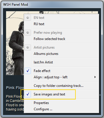

Сообщение #1010 kgena_ua » 14.05.2016, 11:16
Biography Text && Picture. www.last.fm
version "14052016"
Добавлена возможность сохранения текста.
// @version "14052016"
// @feature "v1.4"
DT_LEFT = 0x00000000;
DT_RIGHT = 0x00000002;
DT_CENTER = 0x00000001;
DT_VCENTER = 0x00000004;
DT_SINGLELINE = 0x00000020;
DT_WORDBREAK = 0x00000010;
DT_CALCRECT = 0x00000400;
DT_NOPREFIX = 0x00000800;
var ww = 200, wh = 200;
var font_name_a = window.GetProperty("font name: artist", "Arial");
var font_name_b = window.GetProperty("font name: biography", "Arial");
var font_size_a_d = window.GetProperty("font size: artist (delta)", 0);
var font_size_b = window.GetProperty("font size: biography", 12);
var a_font_style = window.GetProperty("font style: artist", 1);
var b_font_style = window.GetProperty("font style: biography", 0);
var min_font_size = 10;
var max_font_size = 16;
var a_font, b_font;
get_font();
function get_font(){
    a_font = gdi.Font(font_name_a, font_size_b + font_size_a_d, a_font_style);
    b_font = gdi.Font(font_name_b, font_size_b, b_font_style);
ColorTypeCUI = {
    text: 0,
    selection_text: 1,
    inactive_selection_text: 2,
    background: 3,
    selection_background: 4,
    active_item_frame: 6
function get_color(){
get_color();
function on_colors_changed(){
    get_color();
var bgcolor = RGB(31,41,48);
var a_color = RGB(220,220,220);
var transparent = 200;
var nocover_path = window.GetProperty("nocover path",".\\nocover\\nocover.png");
var nocover_transparent = window.GetProperty("nocover transparent (0-255)", 100);
load_last_fm_logo();
var logo_img = gdi.Image(script_path + "last_fm_logo.jpg");
var artist, old_artis;
var path, directory_path;
function clean_name(n) {
    return n.replace(/[\/\:\*\?\"\<\>\|]/g,' ');
    return tmp_b_path + clean_name(n);
function check_folder(n) {
var g_img = null;
var p_margin = window.GetProperty("margin: picture", 10);
var align_mode_a = new Array("adjust", "adjust top - center", "adjust top - left", "centre", "centre - top", "stretch");
var align_mode = window.GetProperty("align mode", 0);
var selected = 0;
var files = [];
var images = [];
var found = 0;
var save_images = window.GetProperty("save images", false);
var limit = window.GetProperty("download limit",5);
var fader = 255;
var fade_step = window.GetProperty("fade step", 5);
var on_pic = false;
var scrollbar = window.GetProperty("scrollbar", true);
var scrollbar_k;
var sb_posy = 0;
var on_sb = false;
var on_sb_down = false;
var b_file;
var t_margin = window.GetProperty("margin: text", 10);
var delta_x, delta_y;
var a_x, a_y;
var b_x, b_y;
var text = "";
var s_text = 0;
var a_text_row_height = 0;
var b_text_row_height = 0;
var b_text_rows = 0;
var b_text_visable_rows = 0;
var b_text_array = [];
var on_artist = false;
var on_text = false;
var on_text_down = false;
var abc_lang = new Array("", "ru/");
var abc = window.GetProperty("abc", 0);
var if_not_found = new Array(". . .", ". . .");
var metadb;
function on_paint(gr){
    paint(gr);
    if(set_cycle){
        set_cycle && gr.GdiDrawText("auto cycle \n" + txt_cycle, b_font, b_color, 15, 15, ww, wh, DT_LEFT | DT_WORD_ELLIPSIS );
    } else{
        gr.FillSolidRect(txt_x, txt_y, ww - txt_x, wh - txt_y, RGBA(getRed(bgcolor),getGreen(bgcolor),getBlue(bgcolor),transparent));
    gr.GdiDrawText(artist, a_font, RGB(0,0,0), a_x + 1, a_y + 2, ww - a_x - t_margin, wh, DT_LEFT | DT_WORD_ELLIPSIS | DT_NOPREFIX );
    gr.GdiDrawText(artist, a_font, a_color, a_x, a_y, ww - a_x - t_margin, wh, DT_LEFT | DT_WORD_ELLIPSIS | DT_NOPREFIX );
    for (var i = 0; i < b_text_visable_rows * 2; i += 2) {
    try {
        gr.GdiDrawText(b_text_array[i + s_text * 2].replace(/^\s+|\s+$/g, ""), b_font, RGB(0,0,0), b_x + 1, b_y + b_text_row_height * i / 2 + 2, ww, wh, DT_LEFT | DT_NOPREFIX );
        gr.GdiDrawText(b_text_array[i + s_text * 2].replace(/^\s+|\s+$/g, ""), b_font, b_color, b_x, b_y + b_text_row_height * i / 2 , ww, wh, DT_LEFT | DT_NOPREFIX );
    } catch(e) {}
    scrollbar && draw_scrollbar(gr);
    gr.GdiDrawText( "", gdi.Font("Arial",12, 0), b_color, 15, 20, ww, wh, DT_LEFT | DT_WORD_ELLIPSIS );
function paint(gr){
    if (g_img){
        gr.DrawImage(g_img, size.x, size.y, size.width, size.height, size.cx, size.cy, size.cwidth, size.cheight, 0, images.length > 0 ? fader : nocover_transparent);
    if (logo_img && images.length == 0 && !nocover){
        gr.DrawImage(logo_img, p_margin, p_margin, logo_img.Width * 0.8, logo_img.Height * 0.8, 0, 0, logo_img.Width, logo_img.Height, 0, 255);

    _menu.AppendMenuItem(MF_ENABLED, 10, "EN text");
    _menu.AppendMenuItem(MF_ENABLED, 11, "RU text");
    _menu.CheckMenuRadioItem(10, 11, abc + 10);
    _menu.EnableMenuItem(abc + 10, 1);
    _menu.AppendMenuItem(MF_ENABLED, 12, "Prefer now playing");
    _menu.AppendMenuItem(MF_ENABLED, 13, "Follow selected track");
    _menu.CheckMenuRadioItem(12, 13 , selection_mode + 12);
   _menu.EnableMenuItem(selection_mode + 12, 1);
    _menu.AppendMenuItem(MF_ENABLED, 14, "Artist pictures");
    _menu.AppendMenuItem(MF_ENABLED, 15, "Albums pictures");
    _menu.CheckMenuRadioItem(14, 15 , select_p_a + 14);
   _menu.EnableMenuItem(select_p_a + 14, 1);
    var is_artist = artist ? MF_ENABLED : MF_GRAYED;
    _menu.AppendMenuItem(is_artist, 16, "last.fm Artist");
    _menu.AppendMenuItem(MF_ENABLED, 17, "Fade effect");
    _menu.CheckMenuItem(17, fade_effect);
    _firstgroup.AppendTo(_menu,MF_ENABLED,  "Align : " + align_mode_a[align_mode]);
    _firstgroup.AppendMenuItem(MF_ENABLED, 20, align_mode_a[0]);
    _firstgroup.AppendMenuItem(MF_ENABLED, 21, align_mode_a[1]);
    _firstgroup.AppendMenuItem(MF_ENABLED, 22, align_mode_a[2]);
    _firstgroup.AppendMenuItem(MF_ENABLED, 23, align_mode_a[3]);
    _firstgroup.AppendMenuItem(MF_ENABLED, 24, align_mode_a[4]);
    _firstgroup.AppendMenuItem(MF_ENABLED, 25, align_mode_a[5]);
    _firstgroup.CheckMenuRadioItem(20, 25, align_mode + 20);
    _firstgroup.EnableMenuItem(align_mode + 20, 1);
    var MF_ = images.length > 0 ? MF_ENABLED : MF_GRAYED;
    _menu.AppendMenuItem(MF_, 30, "Copy to folder containing track...");
    _menu.AppendMenuItem(MF_ENABLED, 40, "Save images and text");
    _menu.CheckMenuItem(40, save_images);
    //_menu.AppendMenuItem(MF_SEPARATOR, 0, 0);
