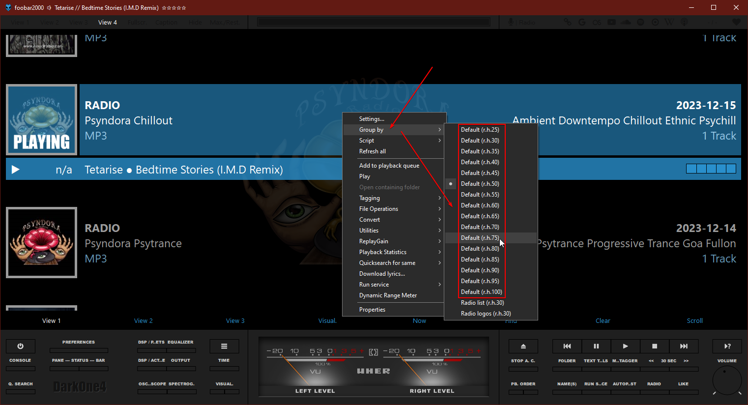

kutuzof, Hi, thank you very much for your help, I have one more question.... Why can't I enlarge the font for album list and ELPlaylist? When I enter any size, the font stays the same, only the font style can be changed.
gajdar79
С нами: 2 года 4 месяца
Сообщение #543 kutuzof » 15.12.2023, 12:22

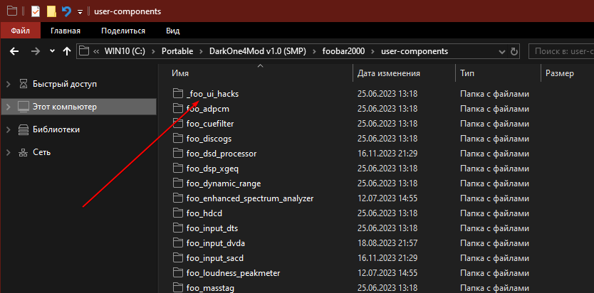

gajdar79:Why can't I enlarge the font for album list and ELPlaylist? When I enter any size, the font stays the same, only the font style can be changed.
This is due to the incompatibility of two components "foo_ui_columns" and "foo_ui_hacks". But this can be circumvented by temporarily disabling the "foo_ui_hacks" component. Rename the component folder "foo_ui_hacks" to "_foo_ui_hacks", change the font size to the desired size, then change the folder name back to "foo_ui_hacks".
And for "ELPlaylist", just right-click, then "Group by" and select the desired row height.

Сообщение #544 gajdar79 » 16.12.2023, 02:03
kutuzof:Rename the component folder "foo_ui_hacks" to "_foo_ui_hacks", change the font size to the desired size, then change the folder name back to "foo_ui_hacks".
Thanks, I wouldn't have figured that out.

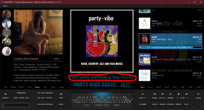

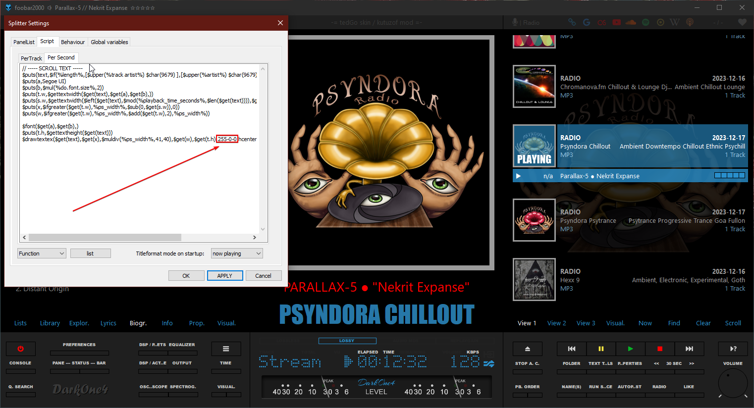

Сообщение #545 gajdar79 » 17.12.2023, 21:25
Hello, Kutuzoff
Can I change the font color under the cover?
gajdar79
Сообщение #546 kutuzof » 17.12.2023, 22:29
Yes, sure...

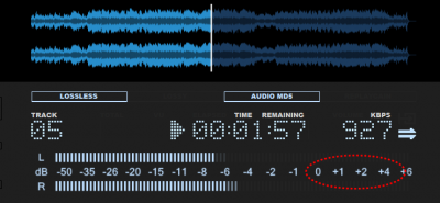

kutuzof добрый вечер, ну тогда и я спрошу про изменение цвета, можно ли изменить цвет у индикатора, когда пики переваливают за 0дб ?
boytronic
Сообщение #548 kutuzof » 18.12.2023, 21:19
boytronic, вот ссылка на исходники (сам переделывать не буду).
https://drive.google.com/file/d/1w7WtyOzA5s4OPlMtnWesEidFOnTEtIoB/view?usp=drive_link

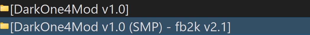

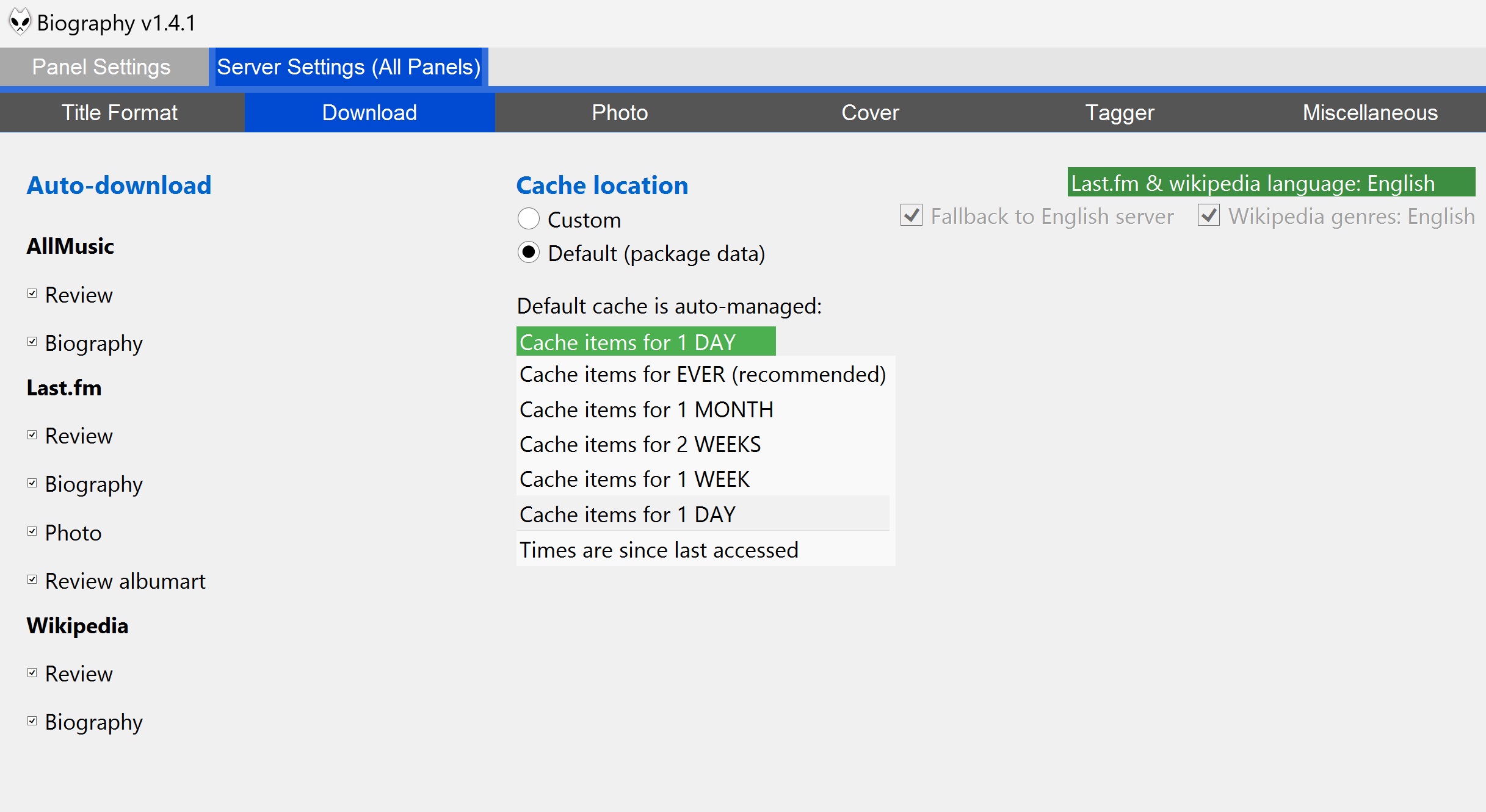

Сообщение #551 pinyuszka » 21.12.2023, 13:56
hi kutuzof!
With foobar2000 v2.1 [x86], my Biography setting is broken.
I set a cache of 1 day because I don't want the images to accumulate.
a DarkOne4Mod v1.0 folder with the images was created above my DarkOne4Mod v1.0 (SMP) - fb2k v2.1 folder.
After some time, the same pictures are loaded on the Biography interface. It doesn't work as intended. I did not experience a similar problem with the previous version v2.0. Is it a unique problem or does it affect version v2.1?

Сообщение #553 kutuzof » 21.12.2023, 19:15
pinyuszka, прочитайте этот пост внимательней: https://foobar2000.ru/forum/viewtopic.php?p=83905#p83905
gajdar79, просто скачайте инсталлятор с официального сайта и установите поверх своей версии.

pinyuszka:It doesn't work as intended.
pinyuszka, новая версия Biography v 1.4.2 от Wil-B должна решить вашу проблему.

Сообщение #556 pinyuszka » 22.12.2023, 12:38

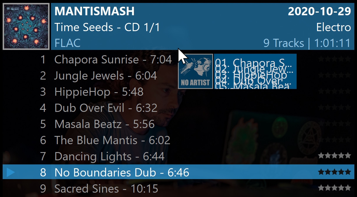

hi kutuzof!
I saved the settings of version 2.0 to the new version 2.1 with the foo_jesus add-on. Everything worked properly. Wil-B Biography v 1.4.2, recommended by you, solved the problem... I copied the foo_spider_monkey_panel.dll.cfg file again from the configuration folder, so Biography works as intended ;)
I have a visual problem, the letters in the picture are scrambled. This window appears when I hold the mouse over the header. how can i stretch the lines?

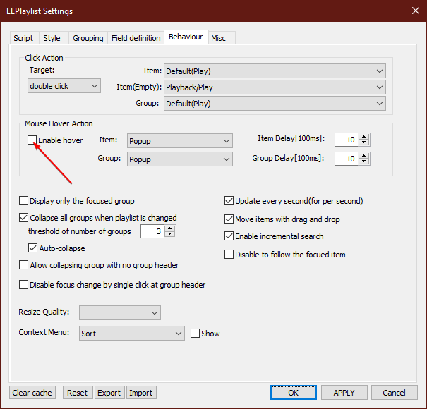

pinyuszka:how can i stretch the lines?
pinyuszka, я не знаю, но вы можете просто отключить это всплывающее окно если оно вам не нужно.
Репутация: 292
Сообщение #558 pinyuszka » 22.12.2023, 22:09
kutuzof:я не знаю, но вы можете просто отключить это всплывающее окно если оно вам не нужно.
This is the best solution, I don't even need this window, it's completely unnecessary.
thanks for the quick response!
