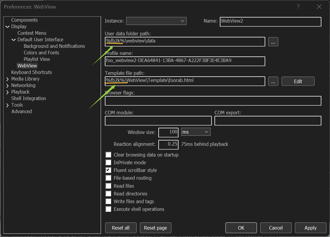

Hi, thanks for implementing FbWindow as a replacement for uihacks. I have three feature requests based on my testing:
‌1. Add Global System Variables for Relative Paths‌, Please add two global variables:
%foobar2000% (or %fb2k%) pointing to the foobar2000 installation directory.
%fb2k_profile% pointing to the user profile/configuration directory.
These should support ‌Title Formatting syntax‌, allowing them to be used directly in JS scripts and path input fields to resolve relative paths. This feature is already available in uihacks and openhacks_mod and is extremely useful for portable setups.
2‌. Fix White Flash on JSplitter Panel During Startup‌

yeyo:Add Global System Variables for Relative Paths‌
Okay, I'll add them, but to avoid conflicts with anyone else's names, I'll prefix them with "jsplitter_" just like I did for the statistics.
