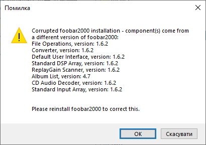

Сообщение #13 postED » 12.01.2021, 14:45
Павловски: Please do not mix files from different foobar2000 releases
I have noticed from crash report data that some users run new foobar2000 exe with old DLLs, presumably because they update foobar2000 by copying just the exe manually extracted from the installer.
Please stop doing this.
For one thing, it means that DLL bugs fixed long ago live forever on your system - including any potential security issues with the decoders.
Additionally, some new core features specifically require new DLLs, such as interop between Properties dialog and ReplayGain scanner. Running mismatching versions is likely to break these features creating obscure issues.
Starting with foobar2000 v1.6.3, people who mix DLL versions will get a warning prompt on each startup. The prompt cannot be disabled.
Would you also expect Windows OS to run correctly if you replaced random system files with ones from a different major release?

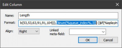

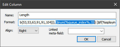

Сообщение #19 SergPuh.68 » 19.01.2021, 10:34
Это отображается индекс очереди.Нужно убрать $num(%queue_index%,3) Edit Columns.У меня так было в колонке Length

SergPuh.68:Нужно убрать $num(%queue_index%,3)
И как же, по-вашему, это сделать в стандартном столбце "Playing" в DUI? К тому же, если его убрать, он не будет отображаться, когда должен - для треков в очереди.
