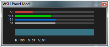

Сообщение #339 kgena_ua » 20.04.2015, 19:40
Скрипт для выбора цвета. Может кому пригодится.
// @name "get R G B"
// @author "kgena_ua"
var font = gdi.Font("Arial",10,1);

function on_paint(gr){
    gr.FillSolidRect (col, y5, width, 20, RGB(R,G,B));
    for (var i = 0; i < 4; i++) {
        var g_color = {
            0: drag == i + 1 || s_line == i + 1 ? RGB(240,60,60) : RGB(200,60,60),
            1: drag == i + 1 || s_line == i + 1 ? RGB(0,255,0)   : RGB(0,200,0),
            2: drag == i + 1 || s_line == i + 1 ? RGB(0,128,255) : RGB(0,107,215),
            3: drag == i + 1 || s_line == i + 1 ? RGB(180,180,180) : RGB(160,160,160)
        gr.GdiDrawText(s_color[i], font, drag == i + 1 || s_line == i + 1 ? RGB(230,230,210) : RGB(170,170,170), tcol, y_line[i] - 4, 25, wh, DT_RIGHT);
        gr.FillSolidRect (col, y_line[i], width, h_line, drag == i + 1 || s_line == i + 1 ? RGB(75,75,75) : RGB(70,70,70));
        i <= 2 && gr.FillSolidRect (col, y_line[i], rgb_step * s_color[i], h_line, g_color[i]);
        i == 3 && gr.FillSolidRect (col, y_line[i], v_step * s_color[i], h_line, g_color[i]);
    gr.GdiDrawText("H: " + H + "   S: " + S + "   V: " + s_color[3], font, RGB(200,200,200), col, wh - 20, ww - col, wh, DT_LEFT | DT_WORD_ELLIPSIS );
