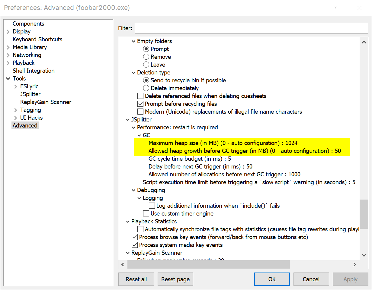

Сообщение #422 LUR » 13.02.2025, 08:35
regor:some changes to current features (which hopefully should be easy to implement), like the limit of heap size at advanced preferences.
SpiderMonkey API has a limit for context memory:
// Create a new context (and runtime) for this thread.
extern JS_PUBLIC_API JSContext* JS_NewContext(uint32_t maxbytes, JSRuntime* parentRuntime = nullptr);
But I can increase the limit for the garbage collection threshold (now it is 256MB).
Добавлено спустя 12 минут 31 секунду:
regor:And please, the limit of 60s on the slow script warning. Allowing a 0 or -1 to disable it and much higher values too. This one alone has provoked a lot of script reports when tagging huge libraries on batch using scripts and similar things.
Do you really think a “slow” script has the right to live in any more or less normally designed program environment? There is a substitution of notions here. It is not a “slow” script, it is a script that is similar to a program that “does not respond”. This should not happen in principle. Any long operation should be executed in a separate thread, allowing the user to continue working or at least to see that the process of execution continues, not hangs. Here is a video example of how to write functions that execute something for a very long time (by the way, judging by your scripts, you know what asynchrony is). And with this approach, you won't even see the “slow script message” because the program will keep responding to your actions:
Добавлено спустя 7 минут 17 секунд:
regor:1. Packages are not loaded properly
Fixed in an upcoming version.

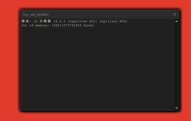

Сообщение #437 dreamawake » 25.05.2025, 18:40
Hi LUR, due to default setting of JSPlitter memory limit, when initially caching the covers of a big library, e.g. 60K+ tracks, it will easily reach the limit and result in crash.
Could you consider increase the default settings or set it to 0 (auto)? (I change to 0 and no crash occurred).
dreamawake
С нами: 2 года 7 месяцев
Сообщение #438 dreamawake » 26.05.2025, 17:53
After testing, it is recommended to set to max values 4096/256, NOT 0/0(auto), auto may cause problem sometime.
