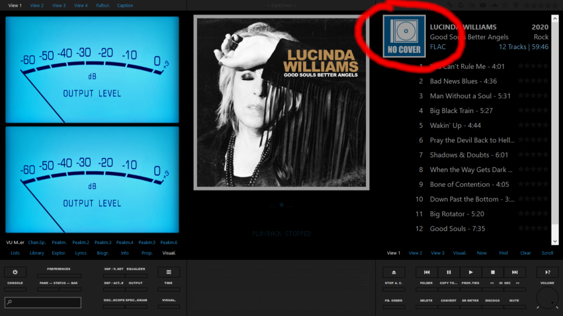

Hi guys, how can i display the artwork here using "folder" as a keyword if i don't have pictures in the metadata? Thank you.
slovak
С нами: 6 лет
Сообщение #158 kutuzof » 25.05.2020, 07:39
slovak, write down your name for the pictures. And if the image file is large, increase the value to the desired one.
