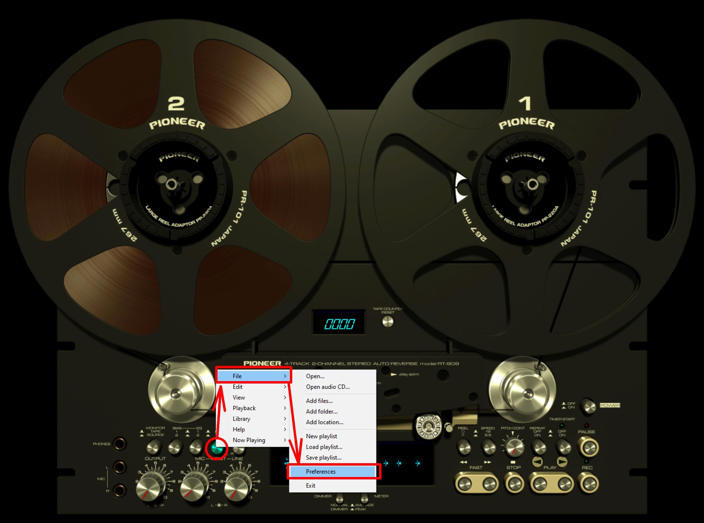

Since I understand almost no Russian myself, I have to rely on detailed descriptions to be able to help.
The settings of foobar2000 can be accessed via button 2, see the screenshot with the menu.
If you still have difficulties, please describe them in more detail. Please do this in detail so that I have a chance to understand it with translation software!
I also need to know from you where foobar displays "44000", what are you doing to make this happen? I can't understand this on my end, can you show us a screenshot?
Did you copy the compilation to C:\ or did you use a different directory?
Function of the individual buttons:
1 Fullscreen
2 Menu
3 Equalizer
4 Settings
5 Albumlist
6 Counter Mode: Normal / Reverse
7 Volume
8 Step Angle Reel: 0° - 100° (How many degrees the reels "jump" from step to step; each step=5°)
9 Blur Value: 0 - 20
10 Show Track Info / Next Preset Track Info / AND MORE WHILE MUSIC PLAYS
11 VU Meter Skin: Select Blue or Red Display AND Reset previous Button 10
12 Previous Title
13 Next Title
14 Stop
15 Play Reverse
16 Play
17 Convert
18 Pause
19 Exit
20 Set Custom Command for Button Timer in file RT-909_Custom.js
21 Playback Order
22 Rotation Interval: 0 ms - 100 ms (How fast the Reels rotate)
23 Set Custom Command for Button Speed in file RT-909_Custom.js
24 Type Reel: PR100 / PR101
Regards
Till Eulenspiegel

Сообщение #7 Till Eulenspiegel » 25.06.2024, 14:35
Please, sorry for the late reply, I didn't see it earlier.
I must confess, this just occurred to me when I was picking out this topic for another post in another thread, that I described the wrong skin here in the previous post, I apologize for that, I've been extremely poorly in health the last few months and not always clear-headed because of the strong medicine.
To access the settings for the beautiful skin of the "Technics RSBX-828 cassette deck" you have to click on the foobar2000 icon in the top left corner of the foobar2000 window and select the "Preferences" option via the "File" menu. Unfortunately, the skin is not nearly as easy to use as the PIONEER RT-909 skin I mistakenly described in my previous post.
Regards
Till Eulenspiegel
Перевод на русский язык с сайта DeepL.com:
Пожалуйста, извините за поздний ответ, я не видел его раньше.
Я должен признаться, я только что понял это, когда я искал эту тему для другого сообщения в другой теме, что я описал неправильный скин здесь в предыдущем сообщении, я извиняюсь за это, я был очень нездоров в последние месяцы и не всегда ясно головой из-за сильных лекарств.
Чтобы получить доступ к настройкам красивого скина "Technics RSBX-828 cassette deck", нужно нажать на иконку foobar2000 в левом верхнем углу окна foobar2000 и выбрать пункт "Preferences" в меню "File". К сожалению, этот скин не так прост в использовании, как скин PIONEER RT-909, который я по ошибке описал в своем предыдущем сообщении.
