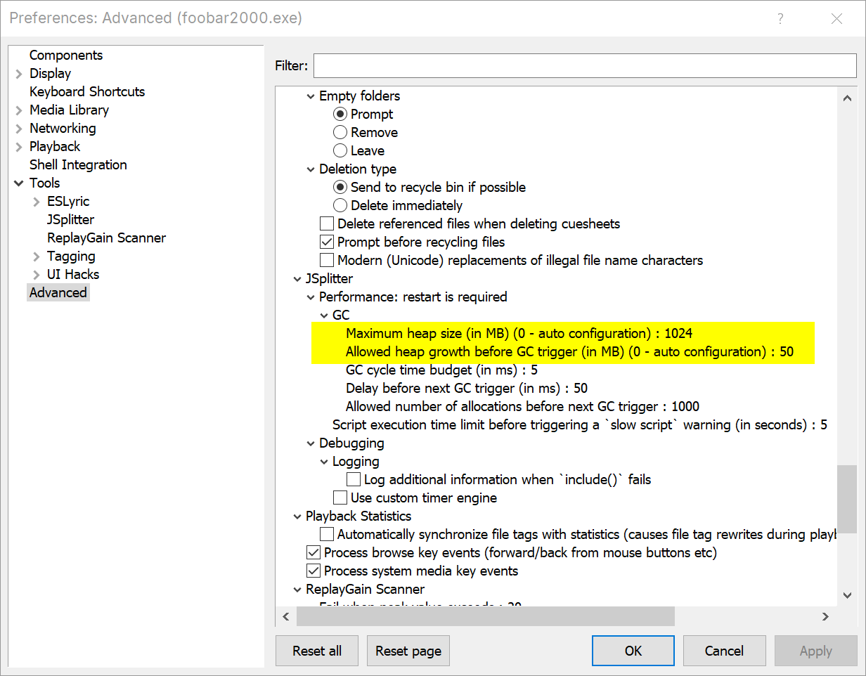

Сообщение #422 LUR » 13.02.2025, 08:35
regor:some changes to current features (which hopefully should be easy to implement), like the limit of heap size at advanced preferences.
SpiderMonkey API has a limit for context memory:
// Create a new context (and runtime) for this thread.
extern JS_PUBLIC_API JSContext* JS_NewContext(uint32_t maxbytes, JSRuntime* parentRuntime = nullptr);
But I can increase the limit for the garbage collection threshold (now it is 256MB).
Добавлено спустя 12 минут 31 секунду:
regor:And please, the limit of 60s on the slow script warning. Allowing a 0 or -1 to disable it and much higher values too. This one alone has provoked a lot of script reports when tagging huge libraries on batch using scripts and similar things.
Do you really think a “slow” script has the right to live in any more or less normally designed program environment? There is a substitution of notions here. It is not a “slow” script, it is a script that is similar to a program that “does not respond”. This should not happen in principle. Any long operation should be executed in a separate thread, allowing the user to continue working or at least to see that the process of execution continues, not hangs. Here is a video example of how to write functions that execute something for a very long time (by the way, judging by your scripts, you know what asynchrony is). And with this approach, you won't even see the “slow script message” because the program will keep responding to your actions:
Добавлено спустя 7 минут 17 секунд:
regor:1. Packages are not loaded properly
Fixed in an upcoming version.
Добавлено спустя 39 секунд:
regor:Have to test other things, not sure if you implemented these fixes:
Added
Добавлено спустя 21 минуту 6 секунд:
regor:There are some remaining important bugs, like ActiveX objects connecting to internet crashing foobar2000 on panel reload/shutdown. Can give more details if needed. In particular 'WinHttp.WinHttpRequest.5.1' or 'Microsoft.XMLHTTP' and their variants.
I have not dealt with these issues, but in my build still lives a large biography script by our forum member. The script hasn't been updated in 3 years almost, but it works. Microsoft.XMLHTTP is there too and nothing crashes.

Сообщение #431 regor » 17.02.2025, 17:43
LUR:SpiderMonkey API has a limit for context memory:
So the max value can not be greater than 4294967295 (in bytes)? i.e. 4 Gbs?
I get your point but there is a misconception here. That warning was added to avoid infinite loops (i.e. program not responding anymore as you say) ok; but the problem is such warnings are useless for actions which require a lot of time since there are not additional threads on SMP (contrary to browsers which have web-workers). Your example is trivial, you are just using async to perform an action which requires a few ms to process, but it's still being processed on the same thread (just later).
See this: https://insights.encora.com/insights/javascript-settimeout-and-promise-under-the-hood
The bottom of the page explains the problem, it doesn't matter if you wrap intensive operations on timeouts or promises since they are still being processed on a single thread (they are just added to the queue after other code), so the process is still blocked at that point.
You can not easily ASYNC process your entire library. i.e. if you retrieve a tag for all tracks from your library, no matter how you do it it will take some time on large libraries. You have these kind of problems for really intensive operations, like fingerprinting matching, track comparison, etc. And the only way to "avoid" it, is by artificcially adding timers without processing between chunks.

Hi LUR, due to default setting of JSPlitter memory limit, when initially caching the covers of a big library, e.g. 60K+ tracks, it will easily reach the limit and result in crash.
Could you consider increase the default settings or set it to 0 (auto)? (I change to 0 and no crash occurred).
dreamawake
С нами: 3 года
Сообщение #438 dreamawake » 26.05.2025, 17:53
After testing, it is recommended to set to max values 4096/256, NOT 0/0(auto), auto may cause problem sometime.
