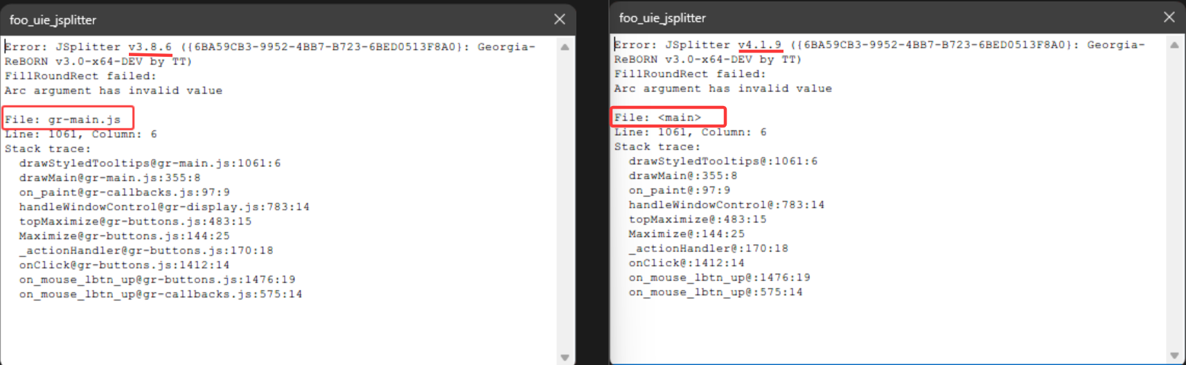

yeyo
С нами: 4 года 1 месяц
Сообщение #514 LUR » 23.06.2026, 12:50
yeyo:The source of the wrong file cannot be correctly identified in the script error report window.
I've been aware of this problem for a long time, but I don't know what to do about it yet, because the results are always different. I'll devote time to this when I have free time.
Репутация: 448

Сообщение #515 LUR » 26.06.2026, 23:25
Версия 4.1.10 [26.06.2026]
  • [ОШИБКА] Исправлено отсутствие имен исходных файлов в стеке вызовов при сбое скрипта
