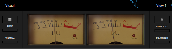

I am facing the same problem which Sennheiser123 already stated above
And I have tried to recalibrate the -60db settings for myself using vu editor
It works nice and can match the value of foobar2000 vu meter finally
But one biggest problem is that the needle won't really stay on -60db even I have already set it to
For example from the first screenshot, I have set the position where the needle should be placed when there is -60db under vu editor angles mode
But from the second screenshot, the needle is not really placing where I have just set in the vu editor angles mode
And from the third screenshot, the real scene when using the vu in foobar2000, the needle is really placing in a wrong place when there is no any playback
I want to know if this is a bug of the vu editor and how can I solve this problem?
Any help would be appreciated, thank you.

To Sennheiser123:
I am working on the accuphase vu previously and without any panel on it to make it clean, but unfortunately there is still problem in between the -40db to -60db stated before, I guess it may be a bug of the vueditor and also I cannot find any newer version of it to try fixing the problem, the current version I have is 2013/2/18, and I found other people is having the same problem in 2021 on the forum: https://foobar2000.club/forum/viewtopic.php?t=4061&start=360, so the problem may be common if wanna create a vu that match the real value (-60 to +3)
I have attached my source file and the bin file anyway which you can have a reference
To Sennheiser123:
Я ранее работал над скином Accuphase VU (делал «чистую» версию без панели). Но, к сожалению, проблема в диапазоне от -40 дБ до -60 дБ, о которой я упоминал, никуда не делась. Мне кажется, это баг самого Vueditor. Я не смог найти более свежую версию программы, чтобы попытаться это исправить (у меня стоит версия от 18.02.2013).
Я также нашел на форуме обсуждение 2021 года, где люди сталкивались с той же проблемой: https://foobar2000.club/forum/viewtopic.php?t=4061&start=360. Видимо, это распространенное явление, если пытаться создать индикатор, точно соответствующий реальным значениям (от -60 до +3).
Прикрепляю свой исходный файл и bin-файл, можешь использовать их для ознакомления.

Сообщение #1055 Sennheiser123 » 07.02.2026, 04:03
thx for the source code
when i use your vu meter the needle in foobar stays at -60 db
before playing a song. looks normal to me.
however, there is another way to get a meter with foobar, e.g. wth mvmeter 2 and a vst plugin for foobar2k.
the values are supposed to be completely accurate, but the disadvantage is that there are only five skins that cannot be changed,
and it is not possible to integrate the display into the foobar gui.
but havent tried that yet.

Сообщение #1056 AyaseMitsukasa » 07.02.2026, 04:19
It does required some workaround in order for the needle to stay at -60 when nothing is playing
For example, the needle should be placed at angle -46.4 originally, but when previewing or exporting it, the needle will just not be placed at -60 but instead placing like -59 or -58 etc
So I have to add an extra offset for it like setting the needle to angle -49.7 so it can stay at -60 when previewing and exporting finally
You can also check that using the source file in vueditor
I haven't tried other vu meter plugin so far or may have a look later, but as you mentioned the skins cannot be changed then it is not quite meaningful as I like the vu meter of accuphase or mcintosh mainly
Для того чтобы стрелка оставалась на -60, когда ничего не играет, действительно приходится прибегать к некоторой хитрости (workaround).
Например, изначально угол должен быть -46.4, но при предпросмотре или экспорте стрелка не встает ровно на -60, а останавливается где-то на -59 или -58. Поэтому мне приходится добавлять дополнительное смещение (offset) — например, выставлять угол -49.7, чтобы в конечном итоге при предпросмотре и экспорте она замирала ровно на -60.
Вы можете проверить это сами, открыв исходный файл в vueditor.
Другие плагины VU-метров я пока не пробовал, возможно, посмотрю позже. Но раз, как вы упомянули, скины менять нельзя, то особого смысла в этом нет, так как мне в основном нравится стиль индикаторов Accuphase или McIntosh.

would be great if you could post this source code again as well.
@kutuzof
Привет!
Не могли бы вы снова загрузить свой исходный код для VU-метра Accuphase A46?
Как и AyaseMitsukasa, я пытаюсь изменить движение стрелки.
К сожалению, ваш исходный код с тех пор неполный. :sad:
Некоторые VU-файлы отсутствуют.
Например, правая сторона скина с 60 дБ и оригинальная передняя часть посередине с
двойной рамкой.
Было бы здорово, если бы вы могли загрузить полный код :-)
Редактирование:
Только что увидел, что синий скин Accuphase с правильным движением стрелки и соответствующими значениями дБ тоже от вас, а не от juri :biggrin:

Strictly speaking, you can listen to music without a VU meter. But if you're going to use a display, it should show values that are as accurate as possible.
With foo_vis_vumeter, you only get approximate values anyway because it works differently than a real Accuphase amp, but it's better than nothing. :smile:
Строго говоря, можно слушать музыку и без VU-метра. Но если вы собираетесь использовать дисплей, он должен показывать максимально точные значения.
С foo_vis_vumeter вы все равно получите только приблизительные значения, потому что он работает иначе, чем настоящий усилитель Accuphase, но это лучше, чем ничего. :smile:
Добавлено спустя 21 минуту 32 секунды:
i tried several vu meter and the blue accuphase vu meter from kutuzof is the best
the values are nearly perfect compared to foobar2k own vu meter :smile:
Я попробовал несколько VU-метров, и синий VU-метр Accuphase от Kutuzof оказался лучшим.
Его показания практически идеальны по сравнению с собственным VU-метром foobar2k :smile:
