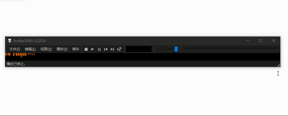

‌1. Add Global System Variables for Relative Paths‌, Please add two global variables:
%foobar2000% (or %fb2k%) pointing to the foobar2000 installation directory.
%fb2k_profile% pointing to the user profile/configuration directory.
These should support ‌Title Formatting syntax‌, allowing them to be used directly in JS scripts and path input fields to resolve relative paths. This feature is already available in uihacks and openhacks_mod and is extremely useful for portable setups.
2‌. Fix White Flash on JSplitter Panel During Startup‌
There is a brief white flash on the JSplitter panel when foobar2000 starts up (observed in Dark mode; unsure about Light mode). This issue also exists in UI-Wizard and the original openhacks. While it may not be a direct bug in FbWindow, openhacks_mod has implemented a clever workaround to suppress this flash. It would be great if you could implement a similar or even better native fix in FbWindow.

yeyo:Add Global System Variables for Relative Paths‌
Okay, I'll add them, but to avoid conflicts with anyone else's names, I'll prefix them with "jsplitter_" just like I did for the statistics.
yeyo:Fix White Flash on JSplitter Panel During Startup‌
It all depends on how your layout is set up. For instance, if I set "JS playlist mod" in root JSplitter panel - it doesn't flicker in dark mode. It’s quite possible yours is sitting in a panel that renders a white background, which is why you're seeing that flash.
yeyo:Double-click the pseudo title bar to maximize/restore the function
Yes, since the mouse is being captured in the pseudo-caption area, it makes sense to add the standard behavior. Although it skips mouse processing if your panel is under the cursor at that moment, I will add an auto-property.

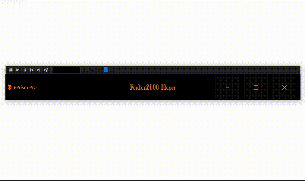

Сообщение #550 yeyo » 02.10.2026, 15:29
LUR:It all depends on how your layout is set up. For instance, if I set "JS playlist mod" in root JSplitter panel - it doesn't flicker in dark mode. It’s quite possible yours is sitting in a panel that renders a white background, which is why you're seeing that flash.
No, I did another test. Even if I set the window substrate to jsplitter, and even set the win11 system to dark mode, when starting foobar2000, the white background will still be displayed first and then the current jsp panel will be correctly rendered. I re-recorded a video and should be able to clearly see the white background flickering problem:
https://drive.google.com/file/d/1BbqCemQqlBGdAn9nMorGUHYdnvxbPfGO/view?usp=sharing
yeyo
С нами: 4 года
Сообщение #551 LUR » 02.10.2026, 15:41
yeyo, Nothing like that is happening to me; watch the video.
https://drive.google.com/file/d/1PSRHG2d2vHz8jrgm1B53pYDMZr5HoKVe/view?usp=sharing

Сообщение #552 yeyo » 02.10.2026, 16:22
LUR:yeyo, Nothing like that is happening to me; watch the video.
In fact, this happens to you too, but the speed deceives your vision. You don’t have to do anything. You just need to load a large number of music directories in the media library and test again. You should be able to reproduce this problem.
yeyo
С нами: 4 года
Сообщение #553 LUR » 02.10.2026, 19:09
yeyo:In fact, this happens to you too, but the speed deceives your vision
I don't know about that. My library of 100k tracks is enough for me—nothing flickers.
