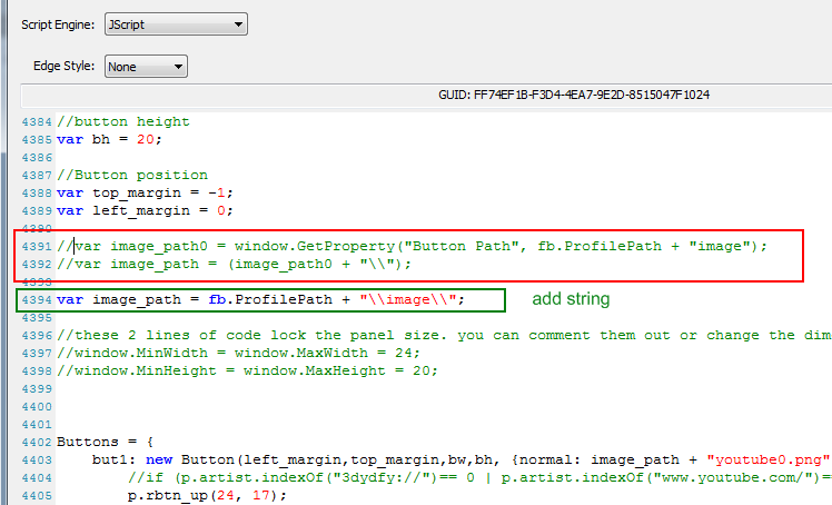

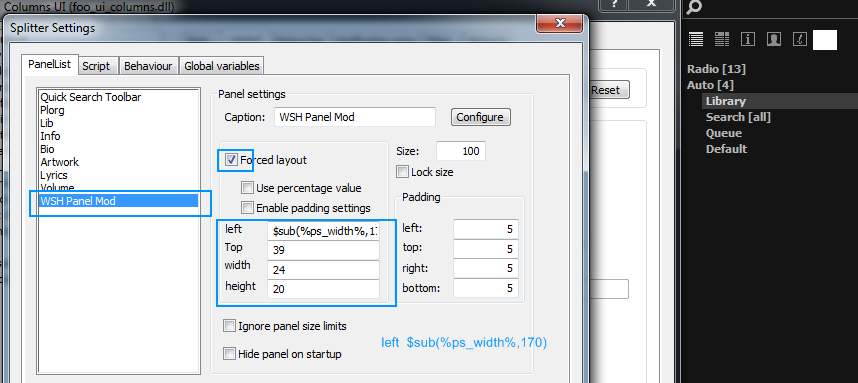

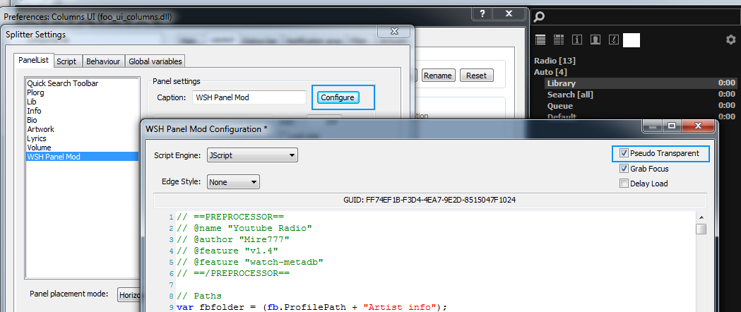

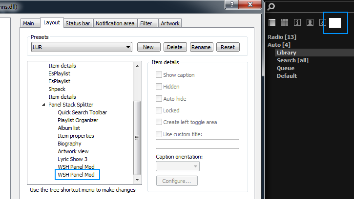

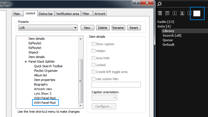

musikomaniak, you must
insert WSH panel
configure panel
place *.png into ..../foobar200/image/ (or change path in the scrip....)
insert script into WSH panel
and
Сообщение #273 musikomaniak » 03.04.2014, 20:27
kgena_ua you explain so well. Many thanks...but I'm MAD!
I did exactly (I think) what you showed, with left:
$sub(%ps_height%, 170)
Why I do not have the same result as you? I installed a new portable foobar.
If I check "Forced Layout", the image disappear.
musikomaniak

Сообщение #276 kgena_ua » 04.04.2014, 07:21
musikomaniak, need change script like below
P.S. Надеюсь LUR не против что я копался в его сборке и выложил ее немного измененную под нужды другого пользователя. :smile:
Сообщение #277 musikomaniak » 04.04.2014, 09:39
Yesss!!!!! :beer:
I hope vladj and Lur will read your solution.
Thank you very very much :smile:
