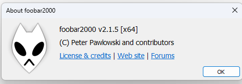

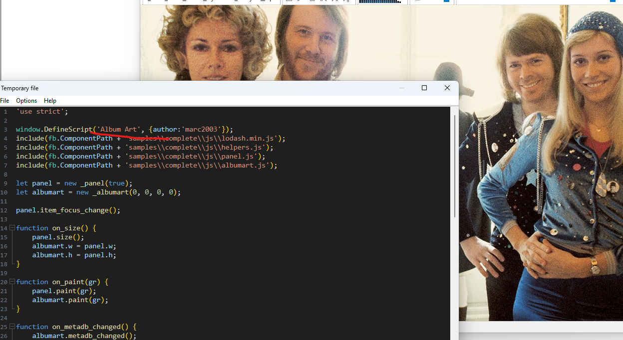

Hi LUR, the 3.6.1.5_x64 version, seems to have compatibility issues with the script panel under SMP-samples, such as running slowly, popping up error dialogs, displaying as a blank panel, etc., is there any room for improvement?
Attached is a crash report!
failure_00000001.rar
yeyo Онлайн
С нами: 3 года 6 месяцев
Сообщение #378 LUR » 06.05.2024, 17:17
yeyo:the 3.6.1.5_x64 version, seems to have compatibility issues with the script panel under SMP-samples, such as running slowly, popping up error dialogs, displaying as a blank panel, etc.
I don't know what are you talking about...
Добавлено спустя 15 минут 13 секунд:
yeyo, check component integrity, reinstall it and reset foobar2000 settings, I can't help you with anything else =)
Репутация: 424
Сообщение #379 yeyo » 07.05.2024, 04:08
Add a couple of panels under SMP-samples, then add the track with the cover and play it, then close and start foobar2000 repeatedly and the problems come out (not every time, there is a probability), these problems only occur under x64, everything works fine under x32.
yeyo Онлайн
Сообщение #380 LUR » 08.05.2024, 03:29
yeyo, I see problems... I will think about it. the error occurs specifically when calling a function of the script execution engine....
