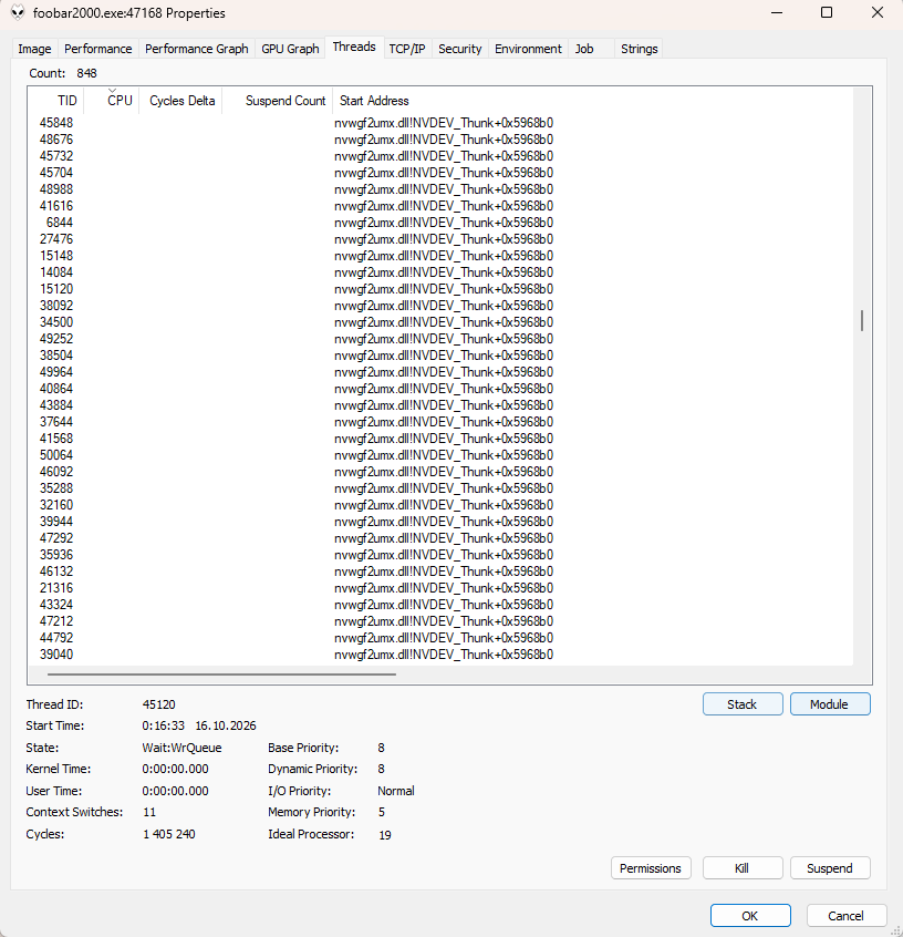

yeyo:I found another problem. When jsplitter is nested with multiple layers of jsplitters and there are many jsplitter panels, even if these panels are all empty without code and the playback is stopped, the CPU will suddenly occupy a lot every few seconds or a period of time (observe the sudden jump in occupation in the task manager). When the default DUI has no jsplitter panels, the CPU basically remains at around 0% occupancy.
I tested a similar setup with many nested, empty JSplitter panels.
I can reproduce noticeable background CPU usage, but only when the panels are using D2D:
window.DrawMode = 1;
The reason is also clear from Process Explorer: each JSplitter panel running in D2D mode creates its own D2D/D3D device, and on my system each such device adds at least about 40 threads inside the NVIDIA user-mode graphics driver (nvwgf2umx.dll). Depending on the moment, the increase can be considerably higher. With many D2D panels (over 30), the process thread count therefore grows into the thousands, and the accumulated graphics-driver overhead becomes visible as background CPU usage which is hardly surprising for any application that already has over two thousand threads, even if they aren't particularly active and are simply waiting for work.
Anyway, in this case, it's driver activity, not the JSplitter's itself.
In a fresh GDI-only layout, where the panels never enable D2D, CPU usage remains effectively at 0% on my system. So in my tests the issue is specifically tied to having a large number of D2D panels.
BTW switching a panel back to:
window.DrawMode = 0;
does not destroy an already-created D2D device (cached). The device remains alive for the lifetime of the panel and is released only when the panel itself is destroyed, so the corresponding driver threads and resources remain as well.
So, if the graphics-driver overhead is a concern, I recommend enabling D2D only for panels that actually need it. There is normally no reason for every nested JSplitter panel or simple container panel to use DrawMode = 1. Panels that do not require D2D-specific rendering can remain in the default GDI mode.

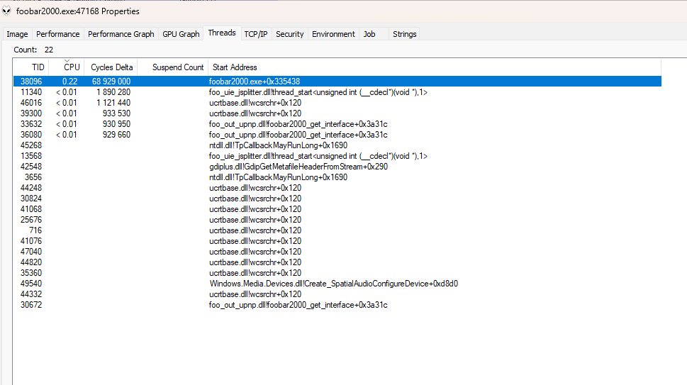

GDI (30 panels):
D2D (30 panels):
