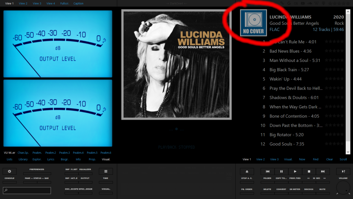

Сообщение #157 slovak » 25.05.2020, 00:36
Hi guys, how can i display the artwork here using "folder" as a keyword if i don't have pictures in the metadata? Thank you.
slovak
С нами: 6 лет 5 месяцев
Сообщение #158 kutuzof » 25.05.2020, 07:39
