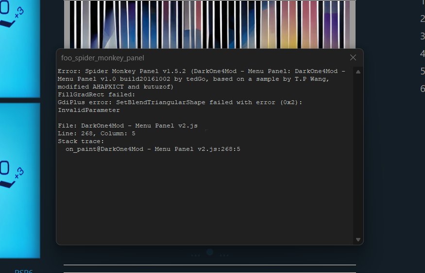

Hi kutuzof, sometimes i got this error, how to fix that? Thank you.

Сообщение #688 kutuzof » 06.01.2025, 15:44
slovak, у меня такая ошибка никогда не выскакивает. Скажите, когда это происходит? Я не уверен, но попробуйте заменить строку 268.
gr.FillGradRect(0, 0, ww, wh, 90, RGBA(39, 61, 77, 255), p_backcol, 1);

Сообщение #689 slovak » 06.01.2025, 20:13
kutuzof, i can' t establish when i got that message, please can you tell me how to change that line, thank you

kutuzof, i got that message when i opened foobar with a music folder already set in playlist and bio panel opened, the message is gone when i cleared the playlist, i don't know...

Сообщение #690 kutuzof » 06.01.2025, 21:52
slovak:please can you tell me how to change that line, thank you
Shift + right click

Сообщение #691 slovak » 07.01.2025, 12:53
Hi kutuzof, i no longer got that error message without changing the line 268, but I will modify just in case of error, thank you.

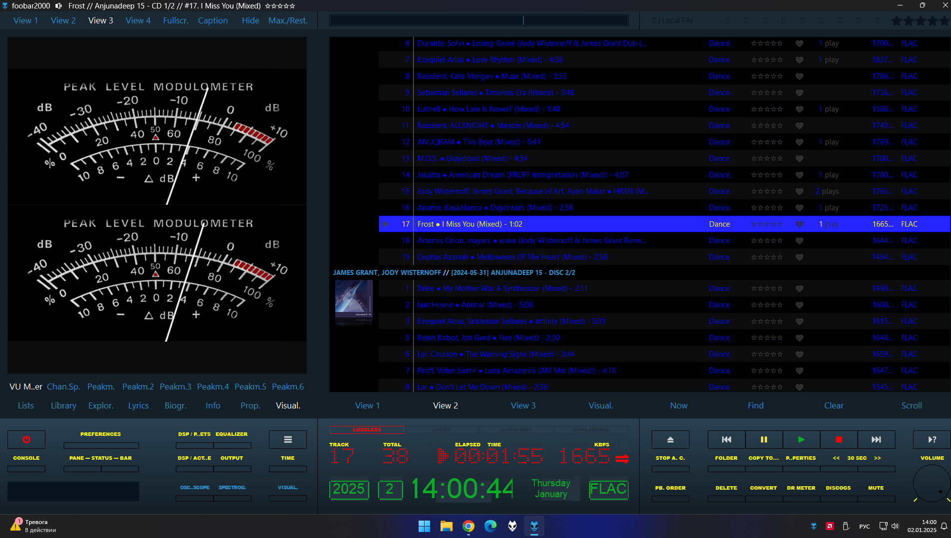

kutuzof, can you tell me how to display the infos on the right panel, thank you.
https://i.ibb.co/M91vMFM/foobar2000-Rti2g1s-Pn-E.png

Сообщение #693 kutuzof » 08.01.2025, 18:13
slovak, просто кликни мышкой по панели в любом месте

Сообщение #694 slovak » 08.01.2025, 19:10
kutuzof, ok thank you
