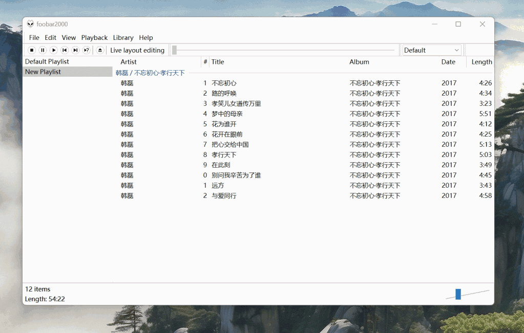

Сообщение #392 yeyo » 20.05.2024, 13:36
I have the same crash in the English version, under the CUI user interface, in the editor window, click on any of the "Options-Presets" in the menu bar, and it crashes immediately, without this problem under the DUI user interface
yeyo
С нами: 3 года 4 месяца
