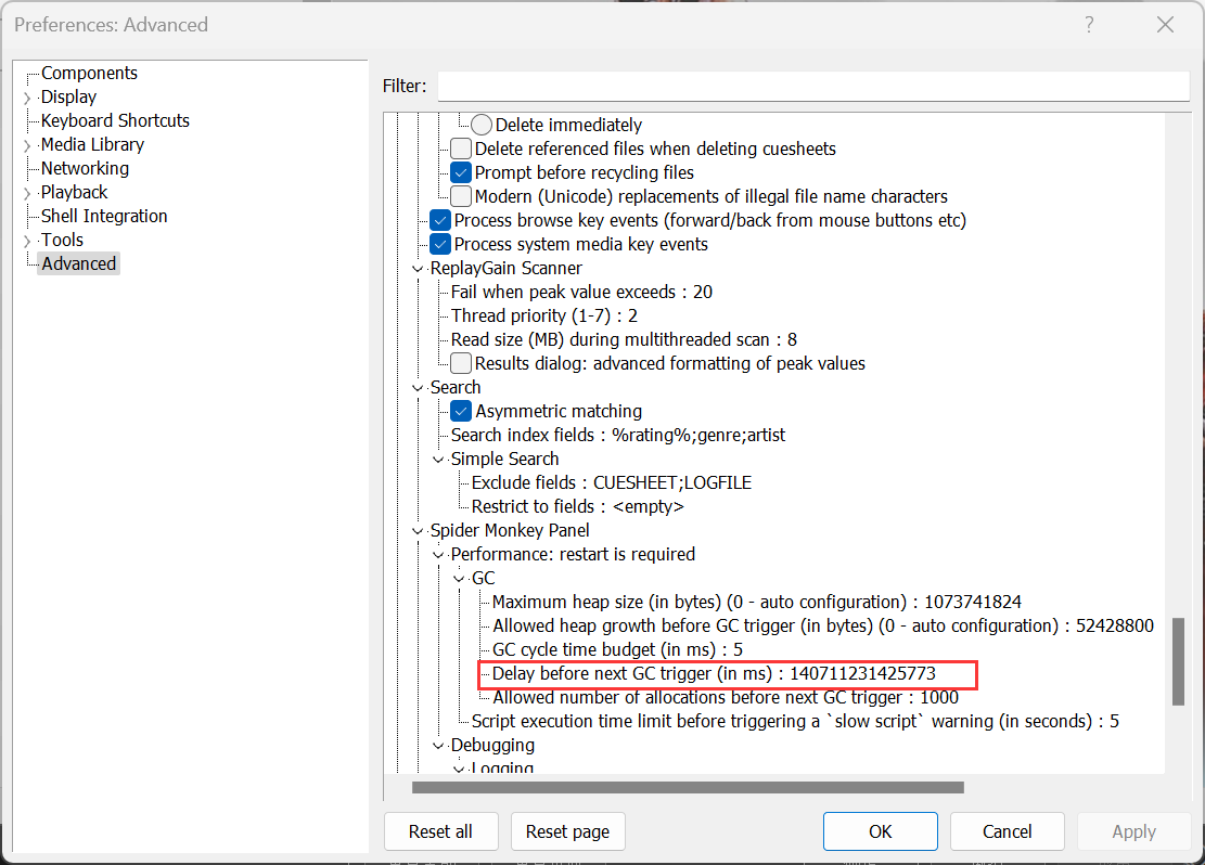

When the foobar2000 window is the active window, I loaded a few panels like jsplaylist-mod under foo_uie_jsplitter\samples here, and the memory can go up by 1GB+ for about 20 minutes of playback, and if the playback time is longer, it may just fill up the amount of memory.
I found the reason why the memory and GDI object values ​​continue to grow. Why are the values ​​​​here so huge? I have never made any settings here. After changing it to 1000, everything became normal.
LUR:I haven't figured out how to reproduce the bug at all. please explain further
I'm sorry! This problem is caused by my translation problem and has been eliminated. You do not need to test again.
Добавлено спустя 4 часа 58 минут:
yeyo:changing it to 1000, everything became normal.
clerical error,changing it to 50, everything became normal.

yeyo:Why are the values ​​​​here so huge? I have never made any settings here.
That's weird. The default value of “Delay before next GC trigger (in ms)” is 50 and cannot be more than 500. This could only happen if the player crashed and the settings were written to disk incorrectly

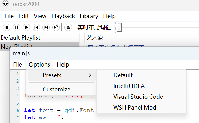

BTW, version 3.6.1.7 x32 and x64, the Editor Window: Options-Presets switch causes foobar2000 to crash as shown below:

yeyo:the Editor Window: Options-Presets switch causes foobar2000 to crash as shown below:
please describe the bug in detail, i need steps to reproduce. error in crash report is about Unicode, I see you're using Chinese. it's a windows error. foobar2000 uses UTF-8 internally, maybe it is missing something. does it happen when you open the menu or where? when building a menu the list of configs in the "editor color schemes" folder is read. All predefined configs in UTF-8 with BOM
Репутация: 456
С нами: 14 лет
Сообщение #392 yeyo » 20.05.2024, 13:36
I have the same crash in the English version, under the CUI user interface, in the editor window, click on any of the "Options-Presets" in the menu bar, and it crashes immediately, without this problem under the DUI user interface

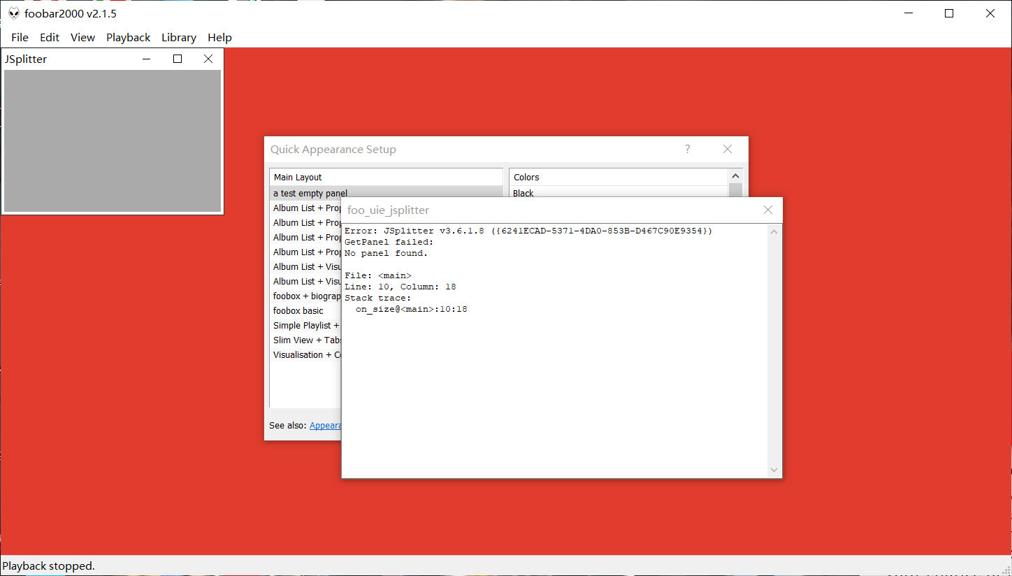

Hi, LUR, below is a long time existing bug that:
If we switch two DUI layouts in View->Layout->Quick Setup, both layouts are formed by JSPlitter and both contain like "xxx = window.GetPanel('yyyy')", the switch will result in crash of the panel:
It will be OK if we switch from a normal DUI (no JSPlitter) to a JSPlitter UI.

dreamawake:If we switch two DUI layouts in View->Layout->Quick Setup, both layouts are formed by JSPlitter and both contain like "xxx = window.GetPanel('yyyy')"
I don't understand how you do this. Please describe step by step.
Репутация: 456
С нами: 14 лет
Сообщение #400 dreamawake » 03.10.2024, 16:12
Attached two very simple DUI-JSplitters layouts for your testing, each contains two JSP panels and only below in on_size() of parent panel:
var SP = window.GetPanel('xxxx');
Please put the layout files in foobar2000\themes folder and switch them in View->Layout->Quick Setup and you can get the crash.
