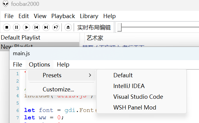

BTW, version 3.6.1.7 x32 and x64, the Editor Window: Options-Presets switch causes foobar2000 to crash as shown below:
Here is the crash report:
failure_00000002.rar

yeyo:the Editor Window: Options-Presets switch causes foobar2000 to crash as shown below:
please describe the bug in detail, i need steps to reproduce. error in crash report is about Unicode, I see you're using Chinese. it's a windows error. foobar2000 uses UTF-8 internally, maybe it is missing something. does it happen when you open the menu or where? when building a menu the list of configs in the "editor color schemes" folder is read. All predefined configs in UTF-8 with BOM

I have the same crash in the English version, under the CUI user interface, in the editor window, click on any of the "Options-Presets" in the menu bar, and it crashes immediately, without this problem under the DUI user interface
