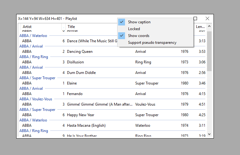

Краткое руководство
Программный интерфейс
window.RadioButtons([a, b]);
Свойства:
(readonly) String Name;
(read, write) String Text;
(read, write) boolean Hidden;
(read, write) boolean Locked;
(read, write) int X;
(read, write) int Y;
(read, write) int Width;
(read, write) int Height;
Методы:
void Show(show = true);
