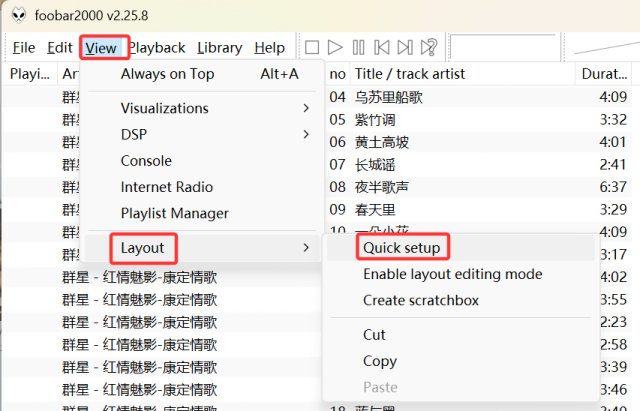

Сообщение #481 yeyo » Вчера, 13:36
@LUR
Enable D2D mode and it is easy to crash when switching the main window layout (View-Layout-Quick Settings-Main Window Layout).
Switching the main window layout in GDI mode with the same layout file will not cause a crash.

Сообщение #482 LUR » Вчера, 16:54
yeyo:View-Layout-Quick Settings-Main Window Layout
I have no such menu entry. Please give me exact instructions to reproduce the bug. If necessary, send me your entire configuration

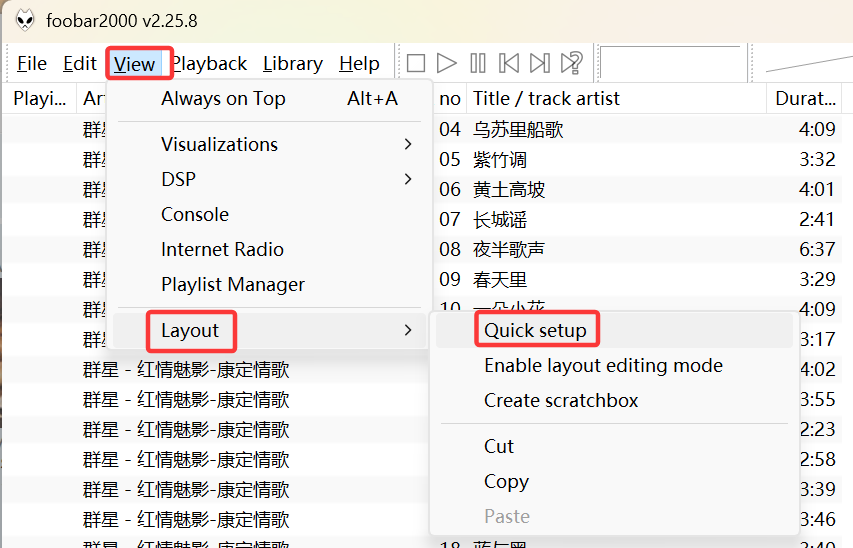

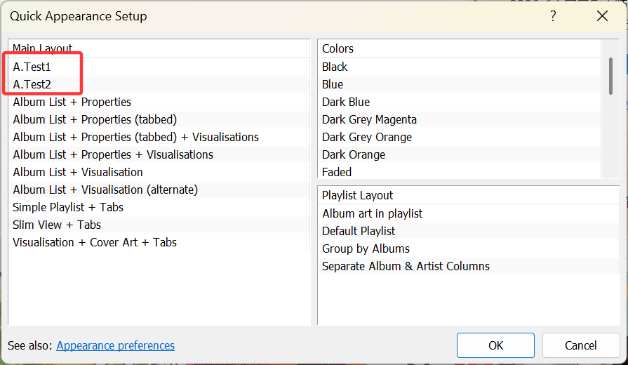

Сообщение #483 yeyo » Сегодня, 06:06
LUR:I have no such menu entry.
LUR:Please give me exact instructions to reproduce the bug. If necessary, send me your entire configuration
I packaged a minimized version:
https://drive.google.com/file/d/12nQ4bjnlTOAV5VS-eJvcX40v8zGJLumC/view?usp=sharing
and when I quickly switched between A.Test1 and A.Test2
it crashed with the crash log in:“foobar2000\profile\crash reports“
