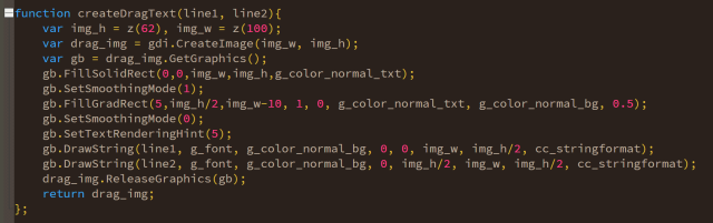

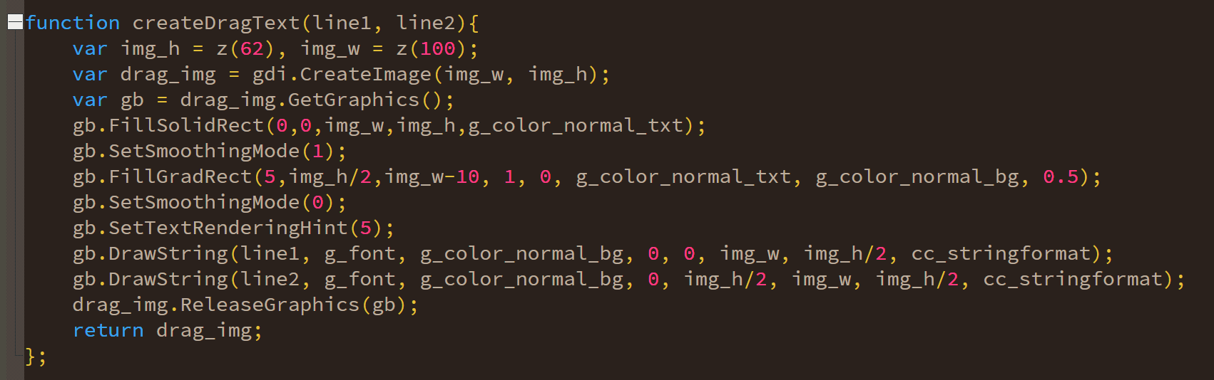

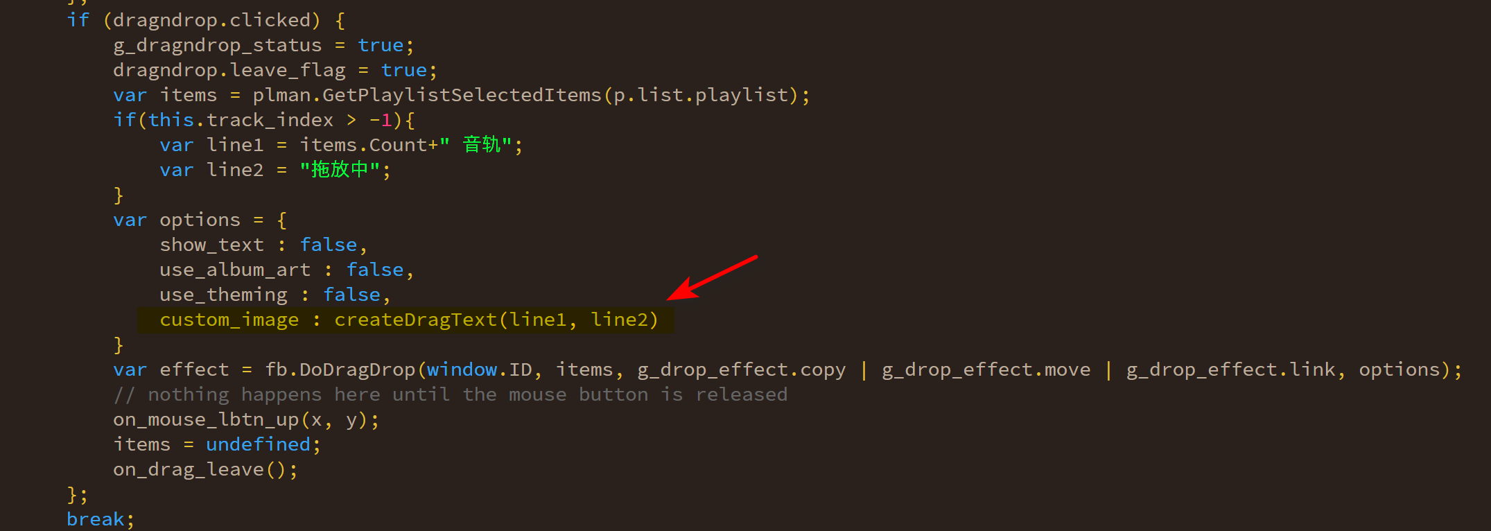

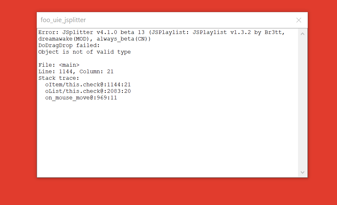

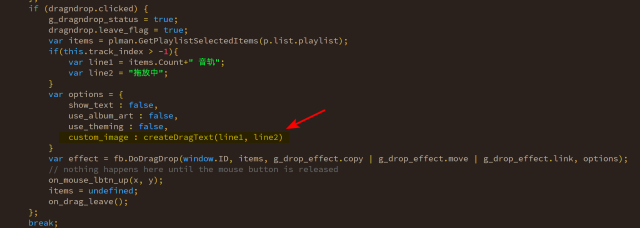

Сообщение #488 dreamawake » Вчера, 16:06
A D2D render mode bug:
execute of fb.DoDragDrop function will cause crash of the panel, due to the custom_image option.
dreamawake
С нами: 3 года
Сообщение #489 LUR » Вчера, 17:10
dreamawake:A D2D render mode bug:
Unfortunately, if an image was created in GDI mode, it won't work for drawing on a panel in D2D mode. Look at where and how the image is created.
Репутация: 425
Сообщение #490 dreamawake » Вчера, 18:08
It is created in the function within same panel (D2D mode enabled). Should it be created with D2D method also?
dreamawake
С нами: 3 года
Сообщение #491 LUR » Вчера, 19:40
dreamawake:Should it be created with D2D method also?
This is not necessary if at the time of the call of gdi.CreateImage window.DrawMode == 1. Looks like I found a bug, thanks for reporting it.
