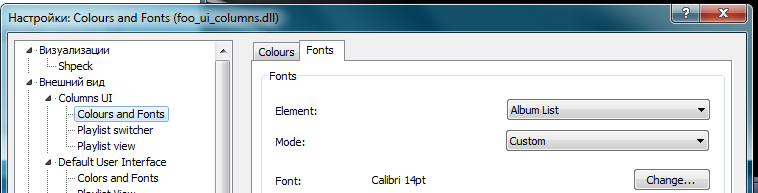

in "Colours and Fonts" I did not find where to inscrease font of All Music list.
Can you help me?
musikomaniak F
Откуда: Paris (France)
С нами: 8 лет 11 месяцев
Сообщение #994 vladj » 30.09.2017, 18:24
Сообщение #995 musikomaniak » 30.09.2017, 19:12
Trank you @vladj (I see, you use Calibri very big) :smile:
